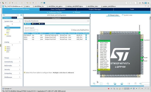

A slightly different approach. Assign the button to an falling edge interrupt then increment both a RED and Green counter for each button press (and there is a considerable amount of bounce). Test each counter for each led in the loop. Assuming the counters are incremented for each button press, this code will turn the RED led on and off every three button pushes and will turn the GREEN led on then off every 5 button presses. Each counter gets set to 0 as the LED gets toggled. Adjust the counters or add additional code as needed for LED control. The >=5 is just to keep the count from getting away.
