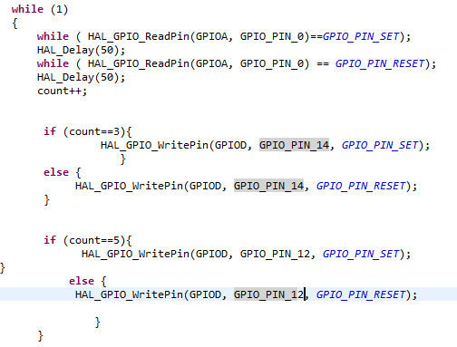

Hello, i'm a new about this embedded systems, i am working with stm32f4 discovery card with HAL Library.
İ looked the GPİO topic and i want to create a program like :
When i clikt the button 3 times red led will open and when i clikc the button 5 times green led will open only.
i create "int count" and i used conditions but couldnt be success about it.
Here is the my code , can anyone help me to show right algorithm?
edit :
Finally it worked :

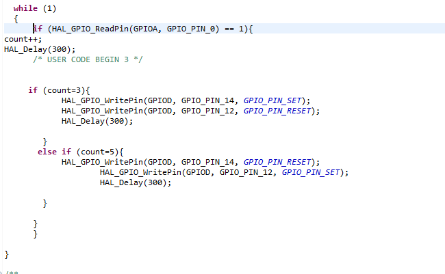

Sorry, guyz. i tried what u said ; however i couldn't do what i want.
when count being 3 then it becomes zero.
i just wanna see red blink when i clickt 3 times and see green when i did 5 times.
2020-09-13 6:42 AM
zero from where? in code example not exist count=0, but i understand you add, but your idea is bad when you wait 5 clicks first arives 3 always...
You need if to check how is led state and when is red wait for 5, otherwise wait for 3....

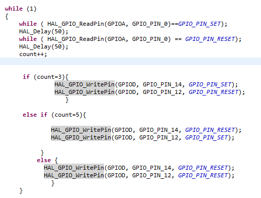

yeah i defined it like global before. Yes, i didnt make good algorithm for it. because when i reach 3 it becomes red with if condition and i cant reach other conditions. So i have problem about it. Maybe it s not important but i wanna solve this.
Now i will try with do while conditons .
2020-09-13 7:09 AM
Yeah, but i couldnt reach green blink( 5 times) again. Because when i click 3 times it red led lighting and there is no change after this.
2020-09-13 7:13 AM
You want "count == 3" and "count == 5" for a comparison.
"count = 3" is an assignment and is always true (3).
2020-09-13 7:18 AM
Yeah, what should i do for a comparison?
