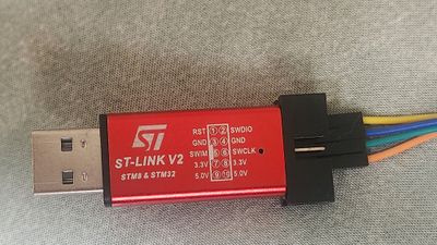

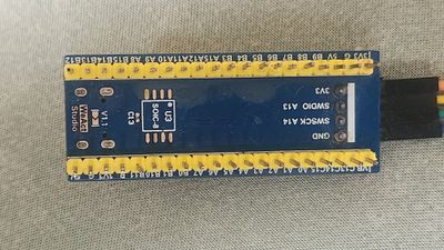

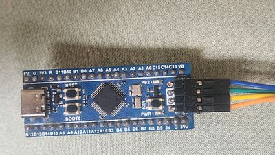

2025-01-01 7:17 PM
here are the pics of the setup ... the st-link looks authentic, but now, I'm so sure about the chip itself. Although I've been led to believe that the WeAct Studio product is good.

2025-01-01 11:41 PM
Hi there,
Thanks for your input.
I didn't know about the St-Link Utility ... found it and used it in conjunction with you instructions.
I was still unable to detect the STM32F103 but I was able to detect and read the STM32F411 Black Pill board that I bought at the same time.
I suspect you may well be right about the F103 board ... it may be damaged or broken.
