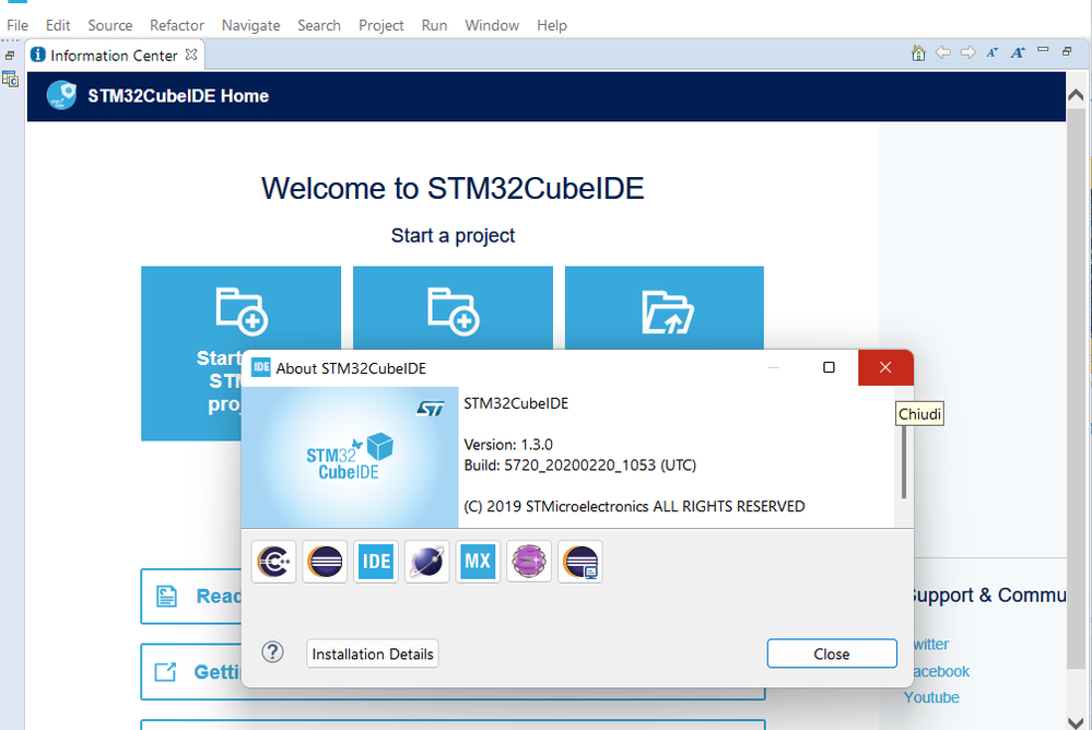

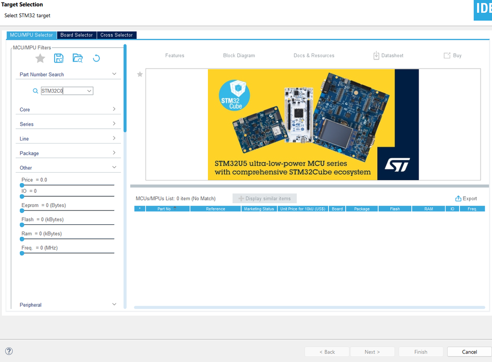

I tried to start a new project with this device: STM32C031C6U6 , but IDE doesn't find it.
I updated the software, but the problem is the same, what must i update for find the device?

Please update and use the latest release of STM32CubeMX and STM32CubeIDE.
The available release 6.13.0 of STM32CubeMX added the support of STM32C0 series.
