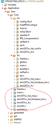

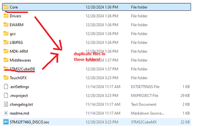

I am confused where my source file should be stored. It seems that I have duplicate files stored in multiple locations. Some seem to get updated together and some don't!
For instance I have a main.h file stored here-> FJB_KEYPAD_R5\STM32CubeIDE\Application\User\Core\Inc and another main.h stored here-> X:\STM32_development\FJB_KEYPAD_R5\Core\Inc
They are not the same and get referenced differently depending on which file I am using.
I only want one main.h!
What is the correct way to store my source and include files?

Yes, I made a couple backups of the project (files) and reloaded it. Plus I probably grabbed some of it from another project. I am trying to learn TouchGFX plus this IDE!
If I go back into mxcube and change anything, then go back into the ide and build I will get several of the duplicate files loaded as shown above. I can just delete them and build again with no errors, but because it creates a new copy of main.c that has any changes I have made, I now need to open the main.c in my APPLICATION/USER/CORE/SRC (stm32ide folder) and copy the changes. I also have an issue with main.h in that I need two copies to build without errors. One in my APPLICATION/USER/CORE/SRC (stm32ide folder) and one in CORE/SRC.
I hope you understand what is going on, because I do not! This IDE is a pain, I spend more time trying to get IDE to work then I do coding. I have used IAR for many years without these issues....I may need to upgrade my ARM IAR for ST soon if this keeps up.
Anyway, I need to correct this as it is a PITA! but not sure how? I hope you can help.
