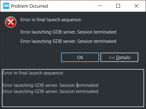

So, I am learning stm32 mcus, using a nucleo f4 board.
Everything was working fine and now debug launch fails.
Actually, I was doing one debug, closed it and next debug session won't launch.
Atollic TrueSTUDIO does work with the same settings (st-link gdb server in the debugger settings).
CubeIDE works in linux.
2019-09-15 4:39 AM
Guys, avast antivirus deletes the st link server exe file. It is absolutely because of it.
I had to add an exception for the exe file.
2019-09-15 2:19 AM
After a few reinstalls, I noticed that when the error raises, in the folder plugins\com.st.stm32cube.ide.mcu.externaltools.stlink-gdb-server.win32_1.0.0.201904160814\tools\bin the st link server execbutable is missing.
On this fresh reinstall, I backed it up.
I'm using avast free antivirus, maybe it is giving me problems. The server is allowed in windows firewall.
2019-09-15 4:39 AM
