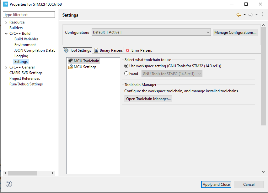

2026-03-05 7:20 AM - last edited on 2026-03-05 7:35 AM by Andrew Neil

2026-03-06 1:56 PM
The project options on your screenshot of CubeIDE 2.1.0 do not look good. The tools settings for the compiler and linker are missing. Something got broken. Try to refresh the project.
