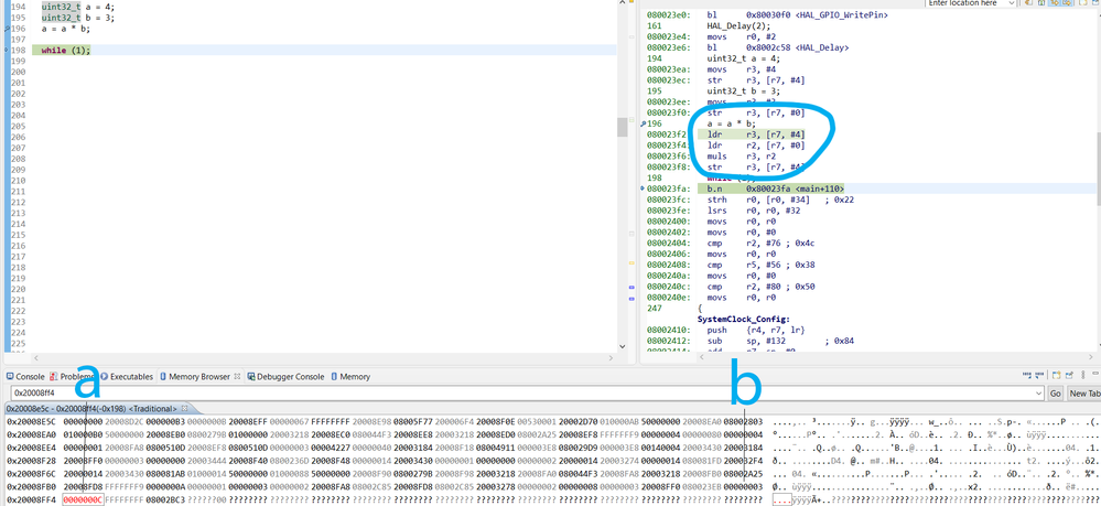

There seems to be a problem multiplying long numbers. Here's what a multiplication of two 32 bit ints looks like.

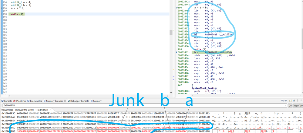

And this is what a multiplication of a 64 bit with a 32 bit int looks like. It works, but in addition to writing the result it also writes a bunch of junk in the memory addresses preceding the variables.
`bl 0x80004e8 <__muldi3>` seems to be the culprit here.

It's normal. What you see changing is the stack.
