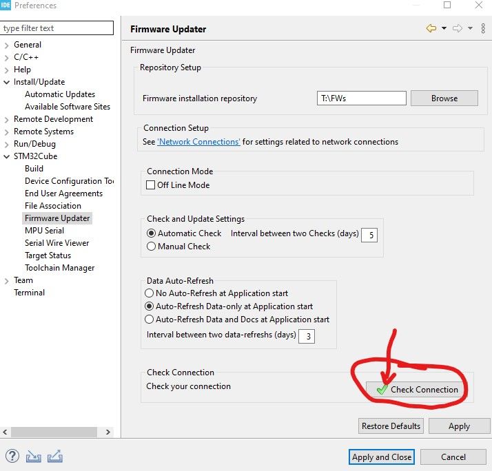

Are you able to get following green check ?
2021-03-26 9:14 AM
Yes
