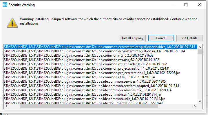

1 The update components are still unsigned :( At least, signature isn't recognized.

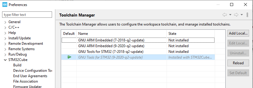

3 After update, the ARM toolchain 9-2020-q2 is installed, but the previous 7-2018-q2 remains installed too.
This IMHO is good because users may want to keep the previous toolchain for existing projects.
Swapping the toolchain on existing project is the proverbial cheese-moving.
This is exactly what happened to my projects: toolchain changed to the new one.
And it won't let me select the 7-2018 although it sits on the disk.
The Toolchain manager thinks it is NOT installed and shows now this:
4 The change of project toolchain clobbered all my debug configurations.
Attempt to create new configuration (based on new toolchain) failed - it still demands the old toolchain for some reason, but Toolchain manager won't find it, as shown above.

3-4/ Do you have any errors when trying to install gcc7 ? If so past them here, plus possibly your workspace log file (workspace/.metadata/.log).
Here is how it is supposed to work: select it and press Install button, let installation proceed into the background (see it in status bar at the bottom-right corner), restart STM32CubeIDE when prompted, and it should be there.
Then you can either set this version at STM32CubeIDE global level from the Toolchain Manager, or per project (see Project Properties > C/C++ Build > Settings > Tools Settings tab > MCU Toolchain).
