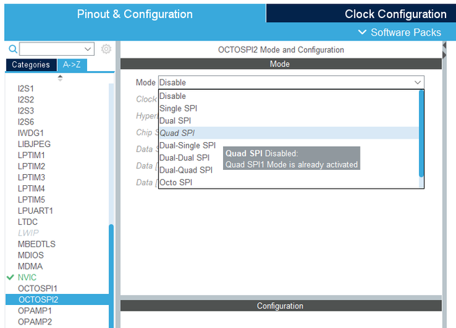

I have a ioc file created with Version 1.18.1, that enables only the OCTOSPI2 (and some RCC and clock settings).
Importing this file (see attachmend) the OCTOSPI2 gets disabled, further more it is non longer possibile to re-enable it as QUAD-SPI!
If added with out migration the IOC it is working as before.

I am having the same issue with a fresh STM32H23VETx project (CubeMX 6.15.0):

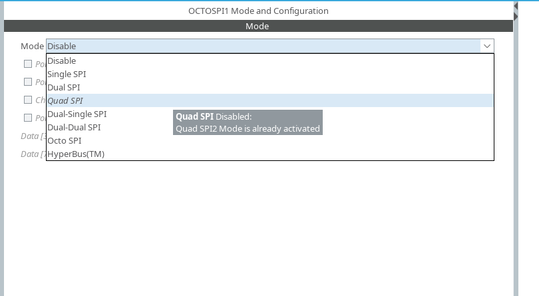

Related: H723 - CubeMX v6.15 cannot utilize the Quad SPI function of OCTOSPI.
