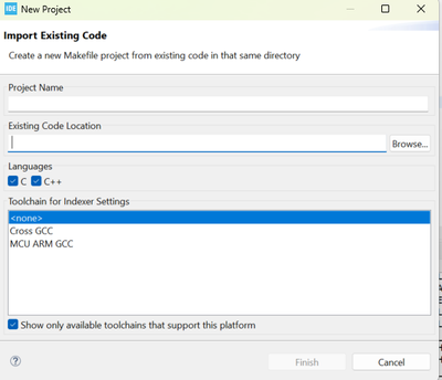

Please try to import your makefile project :File > Import > Existing Code as Makefile Project
In this way STM32CubeIDE will treat your project as an STM32 ARM GCC project, even though you are building externally with your own Makefile. You can then set up a debug configuration pointing to your .elf file, and the IDE should allow you to debug without the previous error.

If I select "MCU ARM GCC" when creating the project and then set the STM32 device manually I am able to debug
Thank you

Hello @Gpeti
I’m glad to hear that the issue has been resolved.
The screenshot I shared displayed the default settings and of course you will need to select "MCU ARM GCC" to proceed.
