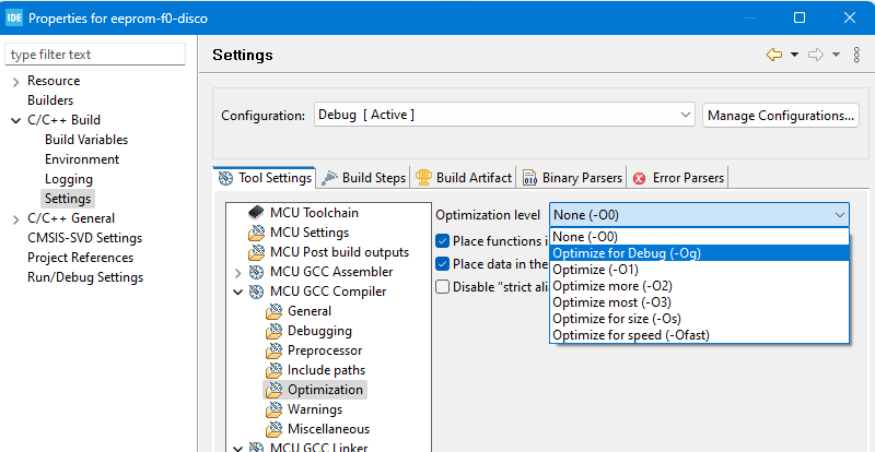

What optimisation level are you using?
Try at least 'Optimise for Debug'

HAL is not designed with small memory footprints in mind. The most you can do is increase your optimization settings for size.

What are difference between the Optimization levels for the -O0, -Og, -O1, -O2, -O3, -Os, -Ofast. What is the pros and cons of these optimization levels. Is this will affect the any other part of the code. When are these levels used?

See the GCC documentation:
https://gcc.gnu.org/onlinedocs/gcc/Optimize-Options.html
Another thing you can do is use the code generator to get you started and then, if you need to, go through the code manually to see what can be pruned out ...
