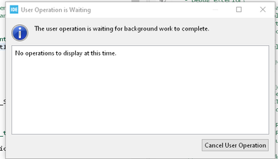

The problems continue, when i start the SMT32CubeIDE 1.19.0 and i try to write any character o IDE i get this screen
And the cubeide do nothing. I need to shutdown using the task manager.
Pavel A.
Super User
Is it a "work" computer - provided by your work or school? If so please ask your IT to help. They could do something to your PC remotely without informing you.
Else, try to disconnect from network/wifi and restart Windows.
pmor
Associate II
I create a new workspace and all works fine again.
I dont know what happen becauso i dont create a new project or files between days.
