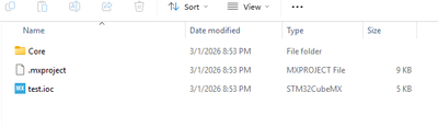

CubeMX does not generate .project and .cproject files for cubeIDE, when in CubeMX project it is selected to not use default firmware location, and path set to folder with STM32Cube FW from github.
To reproduce:
1 Open CubeMX
2 Select File->New Project
3 Select chip, in my case stm32g491ceu6
4 Open Project manager tab, enter name and location for the project, toolchain - stcubeide
5 Uncheck "Use Default Firmware Location", Click Browse and navigate to a folder with github repository with cude FW package
6 Go to "Code Generator" sub tab, select radio button "Add nevessary library files as reference in the toolchainproject configuration file"
7 Click generate
8 Observe folder content in the file explorer - .cproject and .project are missing.
CubeMX version 6.16.1

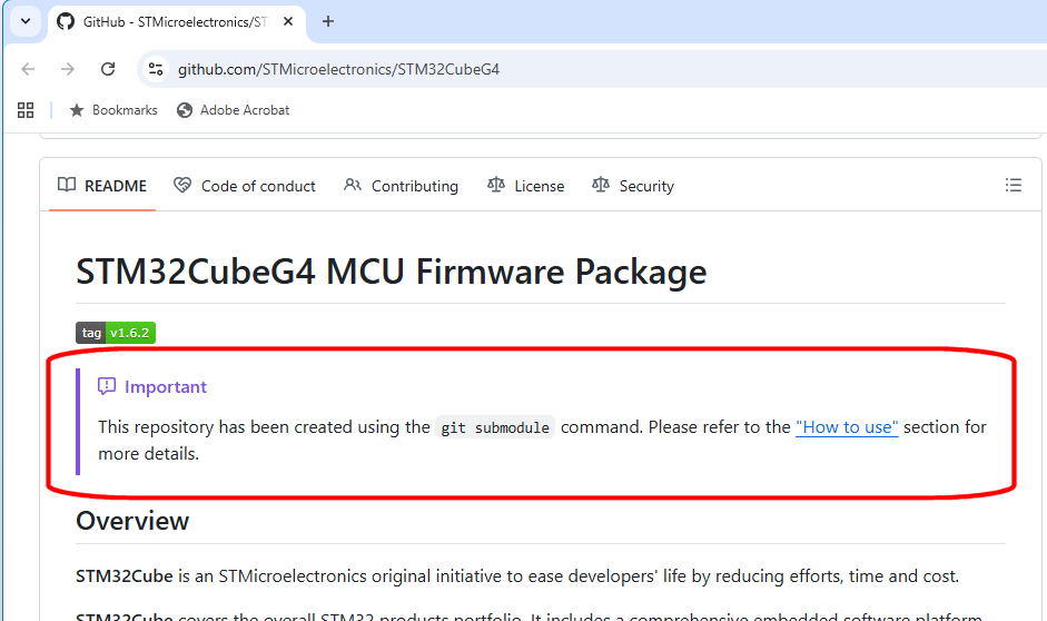

@trs wrote:a github repo (https://github.com/STMicroelectronics/STM32CubeG4) cloned on my machine,
ST's GitHub repos rely on submodules - so you have to follow the instructions to clone correctly:
Did you do that?

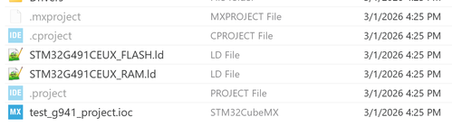

2026-03-01 1:28 PM
Just tried this and both .project and .cproject showed up as expected. Maybe you missed a dialog box, or maybe you have some other project setting which is incorrect, or maybe you have "dot" files hidden.

2026-03-01 7:00 PM
Thank you for support. Attaching my STM32CubeMX project with the IOC file.
These are all files that I get after pressing Generate button.

2026-03-02 3:37 PM
If you open IOC file I shared before, can you get to generate STM32CubeIDE project?
As soon as I check the box "Use Default Firmware Location" the project generates normally. Then if I uncheck the checkbox, click Browse and navigate to a github repo (https://github.com/STMicroelectronics/STM32CubeG4) cloned on my machine, all files in the project's Drivers folder are gone, and there is no path in .project file to any source file anymore, including main.c.
The GUI says Relative path, which is I suppose automatically resolved into a relative path, as there is no way to paste any text into the text box. The only way to set the path is to click Browse button. Is it not the case on your side?
