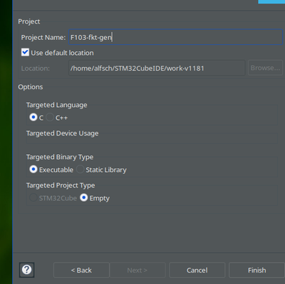

2025-07-09 1:17 AM
Hi @Ghofrane GSOURI ,
i just tried -> new STM32 project --- but also here in IDE 1.18.1 , only "empty" , no "Cube" project can be selected.
Two weeks ago i made last project, for Cube with ioc , worked as usual.
So what happened ? Online update to no more working setup ? Why ??

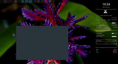

2025-07-09 1:36 AM - edited 2025-07-09 1:39 AM
so i deleted cache, start IDE ...crash...now it looks like this:
grey splash screen :)
2025-07-09 1:49 AM
Hello @AScha.3
first close all ST applications and clean your environment by deleting the folders .stm32cufinder, .stm32cubemx, and .stm32cubeide from your PC. Then, relaunch the IDE and use the Help → Check for Updates option to update the software and packages. If problems continue, uninstall STM32CubeIDE completely and reinstall the latest version to ensure a clean and stable setup.

2025-07-09 1:51 AM
..with new workspace :
Cube cannot select..

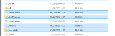

2025-07-09 7:17 AM
Hello @AScha.3
Please try to
-Close STM32CubeIDE
-Delete all those files from your PC: .stm32cufinder, .stm32cubemx, .stm32cubeide and .stm32cube
then restart the STM32CubeIDE and retest again.
2025-07-09 9:34 AM
great ! One of these is the "bad" .
Generates Cube project again.
Thanks for your effort. :)
