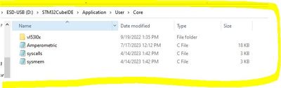

I am trying to export (and then import) a project on STMIDE from one computer to another but it's been not so straight forward. Hoping somebody can point me to the right direction or a step by step on how this is properly done.
For context, when I export the project and try to import into another computer - the project is missing nearly all of the files except for a few..?

What I'm also noticing is that when I copy the project over the files aren't being copied into the STMCUBEIDe folder but somehow the IDE sees that the .c files should be there? Attached another photo.
Thanks
2023-07-21 12:58 PM
Try to find where those files are in original PC file system with windows resource manager. Maybe those are linked outside of project folder to the project :thinking_face:
