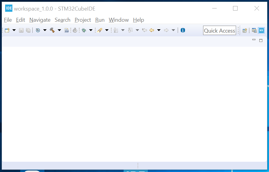

I imported a project (from Atollic) and am able to build/debug.
However, clicking on the "MX" perspective icon gives a completely blank screen (image below). Sometimes it shows files from the C/C++ perspective. But I can't find CubeMX.
What's going on?

2019-05-13 8:17 AM
An imported project doesn't get the .ioc file as they're only in originally created STM32 projects (File -> New -> STM32 Project). If I import a project I don't get the blank space, though. I see the same file I had in the C/C++ perspective although the Build Analyzer and Console views etc goes away.
2019-05-13 9:04 AM
The project's .ioc file is in the imported project at the top level.
If I go back to C/C++ perspective and double-click on the .ioc,
it does convert to 5.2 and correctly open the CubeMX perspective.
When I generated code, it deleted all my existing code
from src and deleted code I added under middleware
(for example the current version of LwIP with corrections).
This is really not good!
A blank CubeMX perspective without anything seems like a bug.
It continues to show C++ source files - but no CubeMX panels.
It seems to be quite lost if opened from the perspective button
prior doing the above steps.
Thanks,
Best Regards, Dave
2019-05-14 5:55 AM
I thought you meant a TrueSTUDIO generated project but you mean a project generated by stand-alone CubeMX generated for TrueSTUDIO and later imported into CubeIDE, right?
If so then yes, that is a bug and it's listed under the known issues of the release notes as:
"Importing the ioc file created by stand-alone STM32CubeMX is not supported."

2022-11-02 6:44 AM
Has anything happened regarding the correction of this bug?
In the meantime, I manage to open the .ioc file as "Open with -> Other... -> External programs, and select any version of CubeMX that corresponds to your original .ioc file. And no "Generate file", only "Save".
It works for me !
