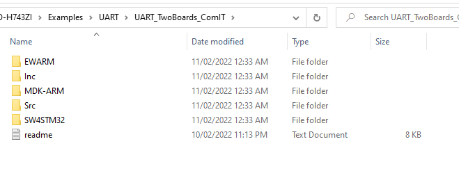

I’ve downloaded the STM32 Cube H7 example folders and I think the NUCLEO-H743ZI folder is most relevant (I’m using the H743 micro for this project at work), and from there there are a multitude of examples under various folders such as UART. I could choose, for example, the UART_TwoBoards_ComIT folder in which we see the following structure:
From this point what is the correct procedure that takes this example project into STM32CubeIDE (I’m running version 1.10.1), please ? The EWARM folder does include project files none of which load the project into the IDE.

If you want to load this example in STM32Cube Ide, you have to click on "SW4STM32" folder after that click on "STM32H743ZI-Nucleo" folder , you will find ".project" file , click on it , your project will load into STM32CubeIDE.
