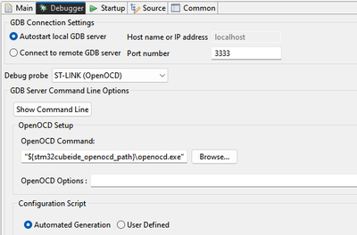

My debug settings are this:
And it -very specifically- happens when stepping in certain parts of the code. Presumably GDB tries to read some variable that it cannot access, or tries to disassemble some code, Idk, but in any case, the debugger fully quites

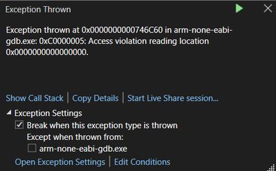

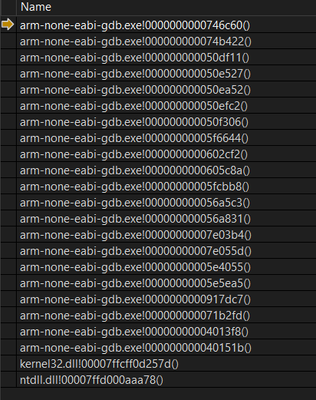

- Attached to arm-none-eabi-gdb.exe through visual studio and checked for execeptions:
GDB indeed crashes
I have no symbol information of the gdb build. But it's clear that the shipped GDB has issues, .. and crashes when stepping through certain lines of code!
