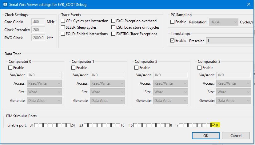

Sorry, forgot the most important setting :
In the SWV console window, click on the config icon and check ITM port 0 enable
Again, the debugger could do this automatically...
