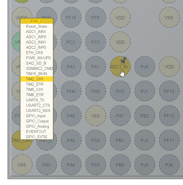

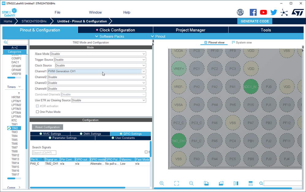

Selecting STM32H750XBH6 (TFBGA 240+25) in CubeMX then directly selecting alternate functions for PA0_C and PA0:
Is selecting TIM2_CH1 for PA0_C, the alternate functions are not available anymore on PA0, which is correct. (The same thing if defining PA0 first)

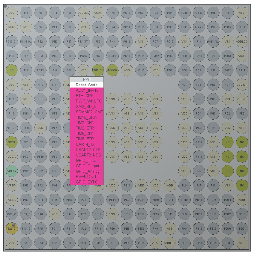

But if PA0 is defined as ADC-input the alternate functions are still available on PA0_C, which is not possible following the pin diagram
see pin diagram from Knowledge Base Default State of STM32H7 switches connecting Pxy_C and Pxy pads:
This also happens if selecting the modules in a certain order:
This results in non functioning generated code (in my opinion - did not test)

Actually you're right, I've been able to reproduce the same misbehavior from my side when using the same configuration as you.
With this being said, this problem is raised internally to be reviewed. I'll keep you posted with the updates.
Internal ticket number: 131671 (This is an internal tracking number and is not accessible or usable by customers).
