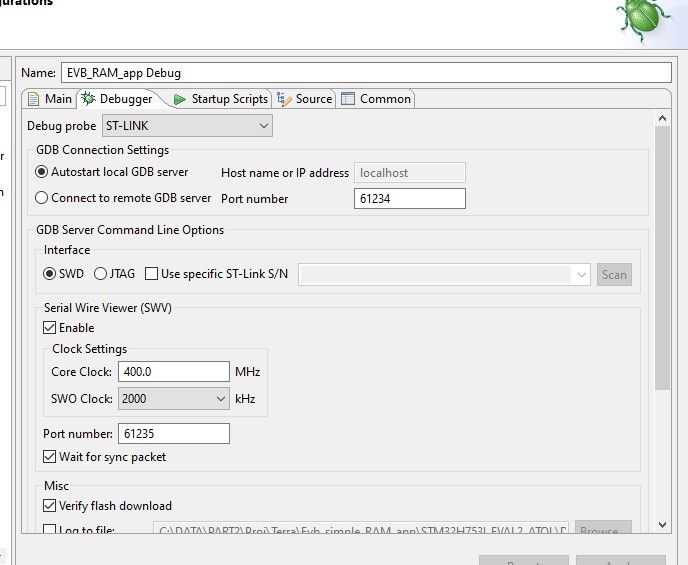

SWO print works fine here on STM32H753I-EVAL2 , wth Atollic 9.3.0 and Keil 5.27 - set up in debugger config as usual, at 400 MHz.

Than you for the feedback.
Could you confirm that you are using STLink GDB server (in Atollic) and SWV Core clock is set to 400MHz, SWO clock to 2000 kHz ?
Could you share the function to init SWD ? (unless it's exactly the same that the one posted by Clive)
Guillaume

Yes. The debugger itself initializes the interface, I don't touch it in the code,
