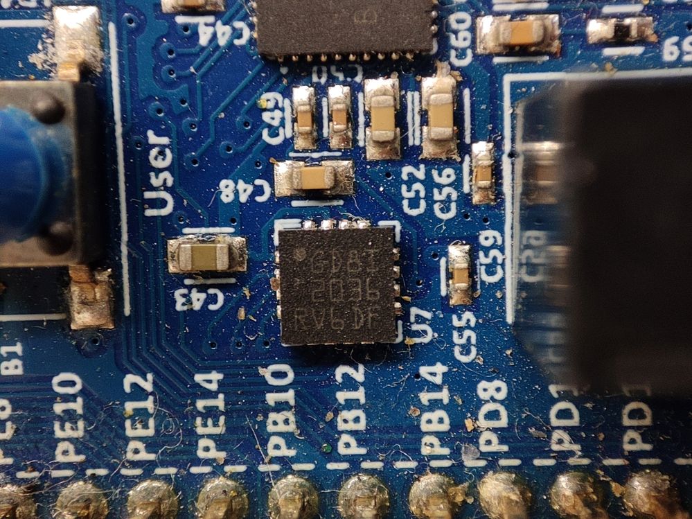

2024-02-12 5:21 AM
Perhaps the chip is not what you think it is.
#define WHO_I_AM_L3G4200D 0xD3 /* for L3G4200D */What hardware is this? Post a high resolution in focus picture of the chip.

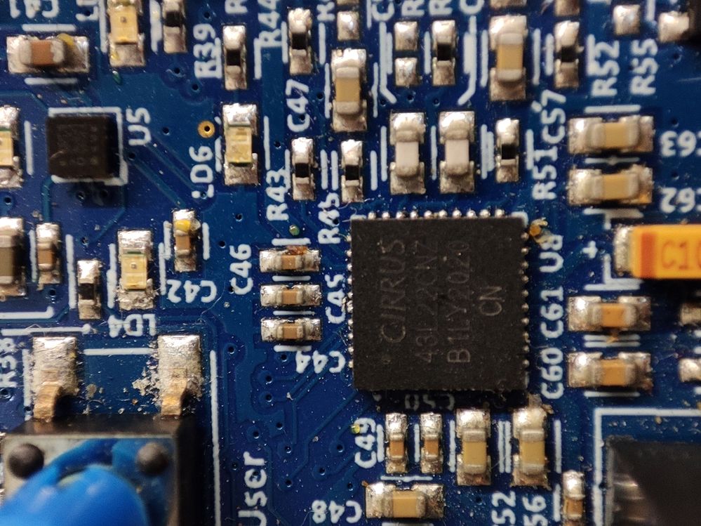

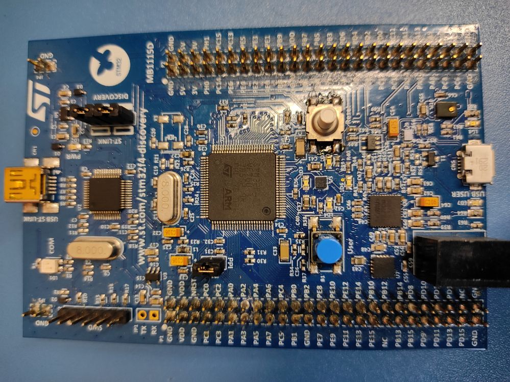

2024-02-12 9:08 PM
I am using STM32F411VET6 and also attaching Images of the controller.
Thanks,

2024-02-13 6:19 AM
Unfortunately, the markings for that sheet are not specified in the datasheet.
I would guess it's actually a L3G4200D chip based on the register value. Perhaps there are other differences in the registers which you could examine to find out.
