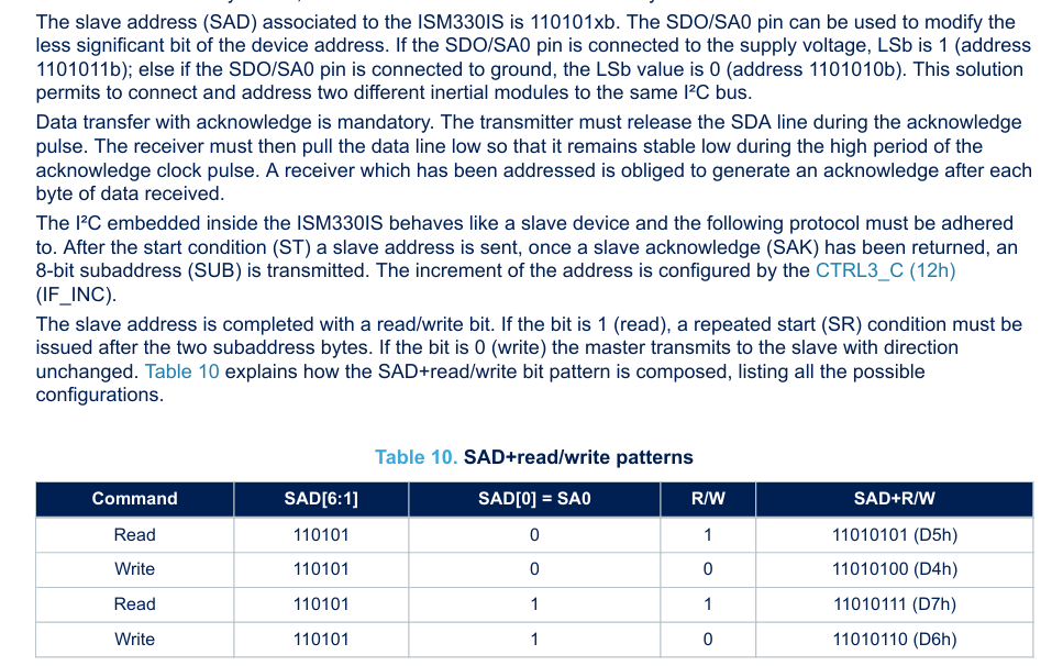

The datasheet of the sensor says 0b1101010 and 0b1101011. On the X-NUCLEO-IKS5A1 the jumper setting is such that SA0=1. After the left shift and adding 1 bit for "read" i get 0xD7U which is ISM330IS_I2C_ADD_H.
I tried both ISM330IS_I2C_ADD_L and ISM330IS_I2C_ADD_H. None of them works.
I am an amateur engineer. I have never used oscilloscope before. I will try next week after familiarizing with the user manual.
Below is the extract from the datasheet and the header file with the macro definition.
2026-01-27 10:09 AM
You don't add the read bit after shifting. The HAL driver will add the read bit when needed.
Your define values should be 0xD4 and 0xD6.
