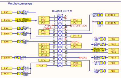

No other changes are needed. However, these pins need to be connected to whatever you're using to get the signal to the computer. This may require solder bridges to be opened/closed if you're accessing via the headers.

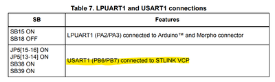

Only PB6/PB7 are intended to be used as the VCP for USART1 and have the native connections on the board.

As @TDK said, they are not connected to the USB-to-UART "Virtual COM Port" (VCP) of the ST-Link in the Nucleo board - so you'll have to make some other connection.
@Fannyrsy wrote:(PB7, PB6) ... I would like to use these pins for the I2C communication
So those pins are connected to the VCP of the ST-Link in the Nucleo board - if you want to use them for I2C instead, then you will need to break that connection...
