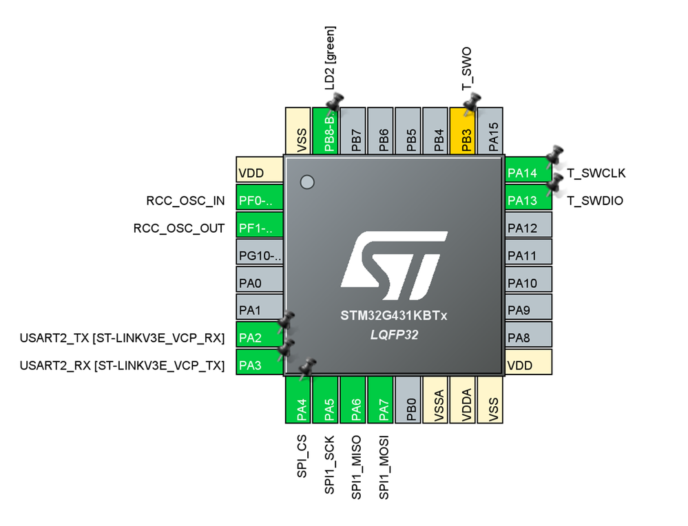

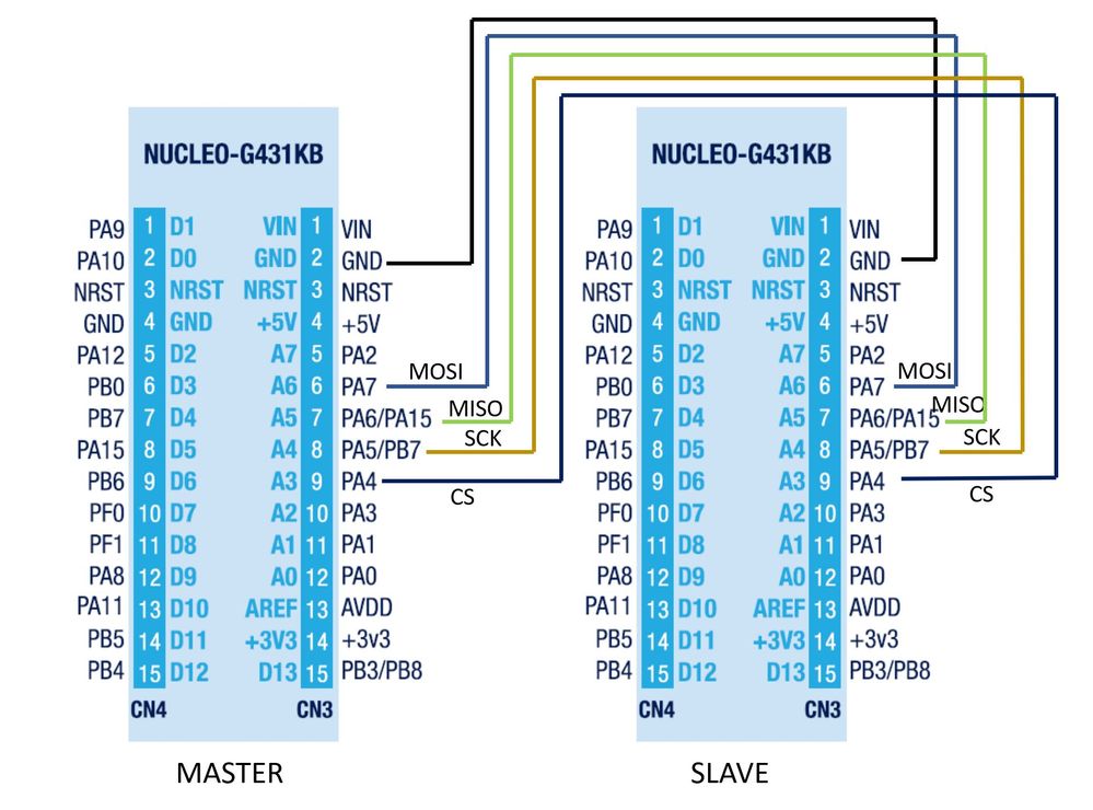

I'm getting introduced to the STM32 environment and I have been trying to use SPI protocol to send messages between these two boards. My setup is as follows:
And in the CubeIDE both boards have this setup, with the difference that the master board has the selection of Full duplex master in SPI and the slave Full duplex slave. The clocks are configured the same way in both boards and I believe I'm not leaving anything.

Observe signals using oscilloscope/LA.
2023-05-04 4:25 AM
...and please check MOSI/MISO:
Currently you have connected output with output and input with input.
So you would have to cross both.
[edit]my assumption was wrong, the wiring is correct[/edit]
Regards
/Peter
2023-05-04 5:16 AM
I see MOSI from master connected to MOSI of slave, and MISO from slave connected to MISO of master, so it's input to output and output to input as it's supposed to be.
2023-05-04 5:21 AM
Oops, you are right, Jan, I was confused with another communication.
