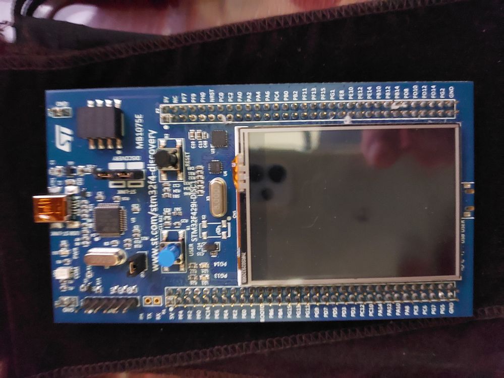

Good morning! I have a problem with the STM32F429I-DISC1 board. I bought this board a few weeks ago and with the STMCubeIde software (v. 1.12.0) I downloaded the BSP example for this board together with the STM32CubeF4 package (v. STM32Cube_FW_F4_V1.27.0). After compiling the project and loading it into the board (Run as STM32 C/C++ Application), the execution hangs during the calibration of the touch-screen (activate the colored circle inside the rectangle). I tried with various PCs with Windows 10 Pro (I7 and I5 with 16 GB of RAM) and also on a Linux Kubuntu v.22.04 machine but the anomaly always occurs. Another example (LTDC_Display_2Layers) works correctly. I also tried to use another STM32F429I-DISC1 card but the problem remains. Can anyone enlighten me on this? Thank you!

2023-04-14 6:01 AM
The execution of the software stops when the colored circles to press appear. Despite pressing with my finger or with a touch-pen, the circles do not color and freeze. I just have to reset:

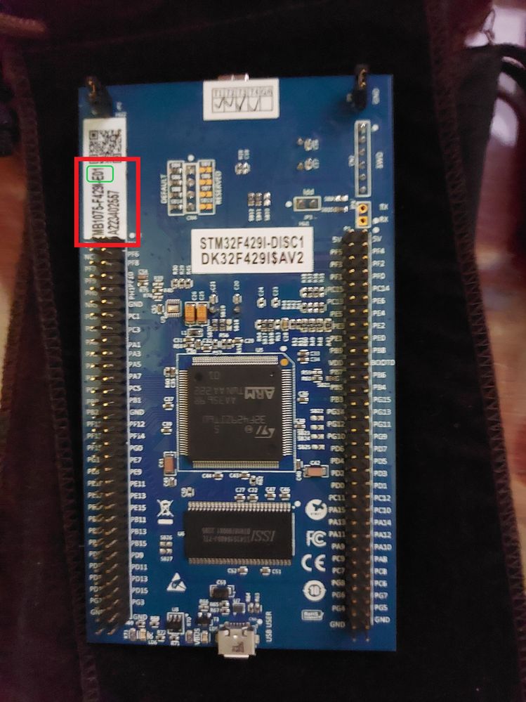

2023-04-25 8:56 AM - edited 2023-11-20 8:10 AM
Good morning and thank you! How do I see the REV of the card? I don't see any indication on the circuit board.

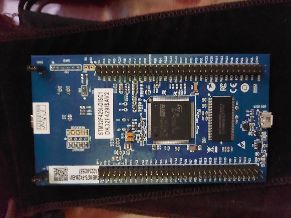

2023-04-25 9:26 AM - edited 2023-11-20 8:11 AM
Hi Alann ,
as mentioned on the picture below , your board is STM32F429I-Discovery RevE.
