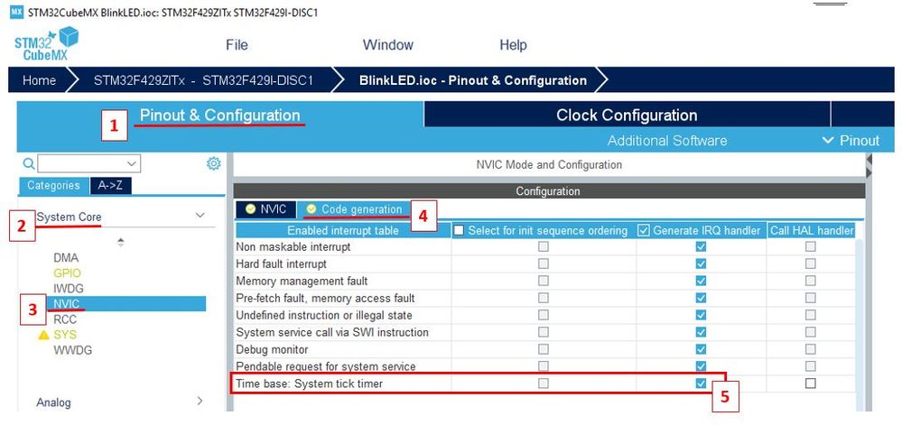

Hi @DCagi.1 ,
I quickly looked at your zip; everything is mixed in all this.
The following link may help you:
Regards.
Cyril
2020-03-30 6:43 AM
2020-03-30 7:45 AM
Hi @DCagi.1 ,
"Generate IRQ handler" is not set for "Time base Sys tick timer" in your STM32CubeMX project (BlinkLED.ioc).
Regards.
Cyril
2020-03-31 1:46 AM
Hi @Cyril FENARD
Eureka! Now it is up a running, thanks a lot for your valuable help. I will try to make some comments in the 1st post, for others to benefit from it.
