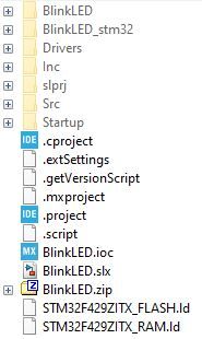

2020-03-17 7:58 AM
Hi @Cyril FENARD
These are the files before compiling the SIMULINK model:
These are the files after:
As you can see, a ".project" is generated, which is the one I open within STM32CubeIDE.
Not sure what you mean by "check the properties of BlinkLED items".
Is this something to modify within the BUILD configuration in SIMULINK? If so, how?
Thanks a lot

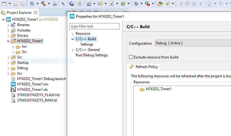

2020-03-17 8:16 AM
Hi @DCagi.1 ,
I share an example of build properties under the STM32CubeIDE view:
Regards,
Cyril

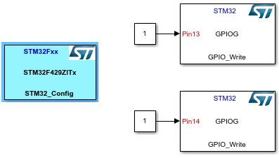

2020-03-23 4:52 AM
Thanks a lot @Cyril FENARD
I get no more errors in STM32CubeIDE.
However, the LED does NOT light on.
I tried to load the .bin generated making use of the STM32-Link Utility, but does NOT work either.
Which part of the code should I check? Which file actually contains "the logic" modelled in Simulink?
This is the Simulink model, and I have attached the Simulink build log file (.txt):
Thanks everyone.
2020-03-23 5:29 AM
Hi @DCagi.1 ,
You have built the final application with the IDE you choose, that is to say the STM32CubeIDE in your case.
You can debug directly using the STM32CubeIDE tool.
BlinkLED.h/c are files generated by the Simulink coder.
You can add a breakpoint in the BlinkLED_step () function. This function should call the HAL GPIO functions.
Regards,
Cyril

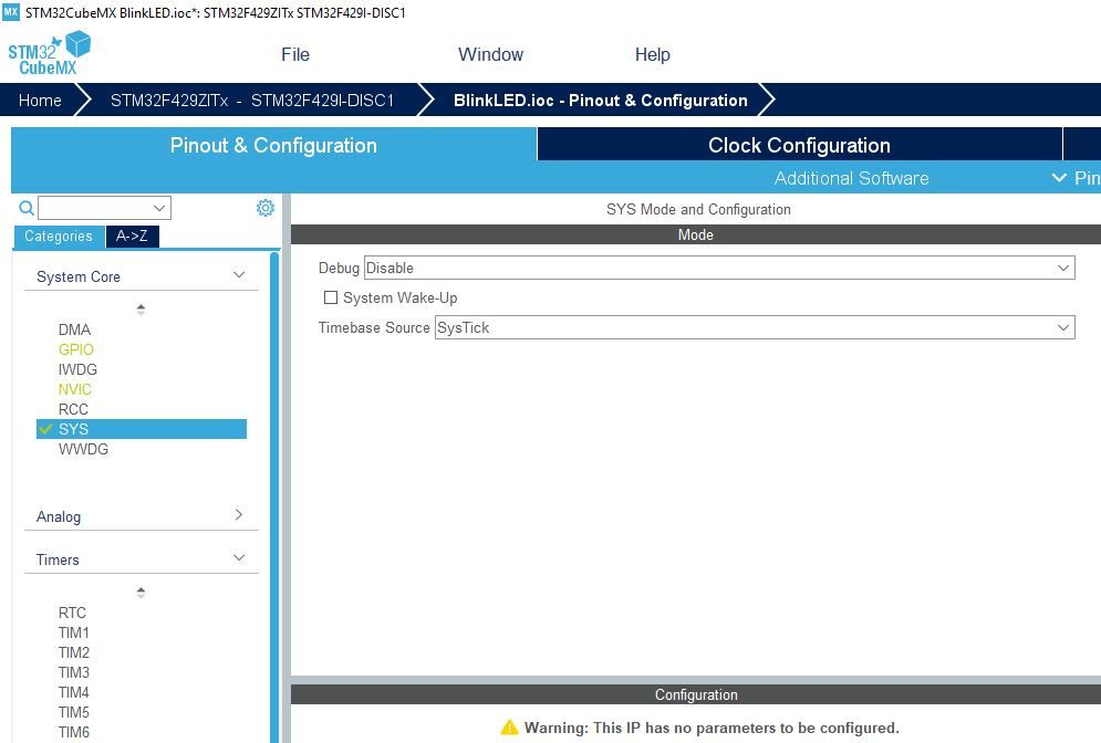

2020-03-30 4:40 AM
Hi @Cyril FENARD
It seems, it never gets to the "BlinkLED_step ()" function, since this variable is always 1: remainAutoReloadTimerLoopVal_S == 1
Could it be related to any configuration of the clock within Stm32CubeMx (.ioc file)?
With the "System Core", selecting the "SYS", the timebase source is set to "SysTick":
Any ideas?
Regards

Hi @DCagi.1 ,
May you also share the stm32xxxx_it.c file?
SysTick_Handler() should be called periodically in you use-case.
Regards.
Cyril
