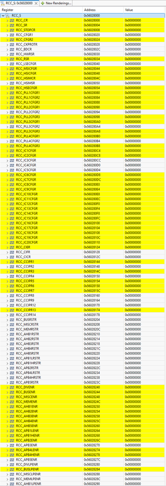

2026-04-27 9:31 AM
@FBL Is it correct that so many registers (see image, marked as yellow) has been cleared after execution of
/* Core Soft Reset */
USBx->GRSTCTL |= USB_OTG_GRSTCTL_CSRST; ?

2026-04-27 10:03 AM
Hi @bureau
I assume it gets cleared after calling reset macro.
RESET_USB_MACRO();
Let me check and will get back to you by tomorrow. I need to check updates with development team. Thank you for your understanding.
2026-04-27 10:29 AM
@FBL
No, it is cleared after call of
USBx->GRSTCTL |= USB_OTG_GRSTCTL_CSRST;which is inside
USB_CoreReset()
