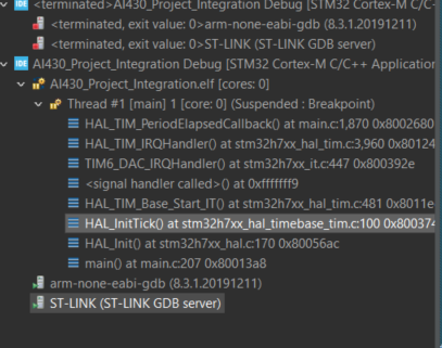

These stack gets called repetitively and does not let me debug.

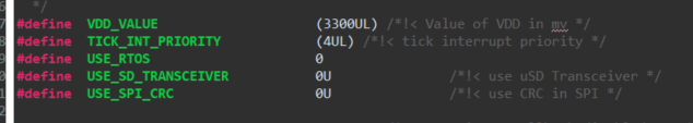

If I reduce the priority of the ticks then HAL_Delay does not work.
I am in a fix here dont know what to do ?
I have changed the tick priority also as shown in the figure.

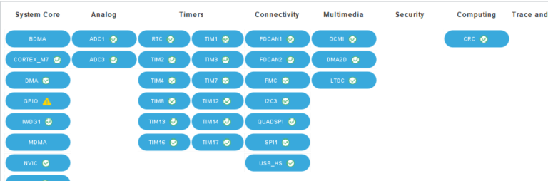

And the most important thing is that I have not configured the TIM6 manually or by cubemx. It was always used in the background by SDRAM. Even in cubemx the TIM6 appears grayed out

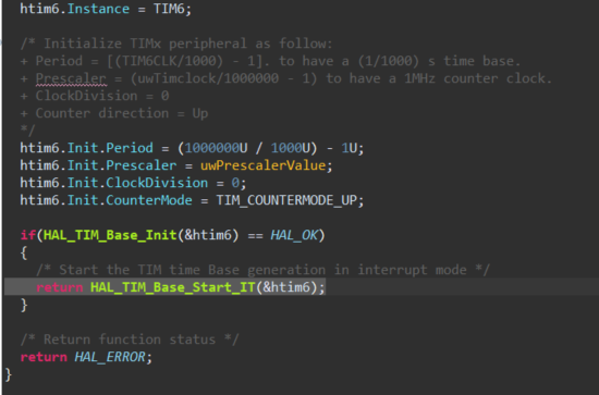

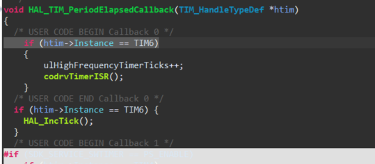

So TIM6 is the SDRAM clock AND the tick clock? And is the interrupt period really 1ms (as it kinda looks like it should be from the code you posted). Is the TIM6 clock really 1MHz as that calculation presumes? And it seems strange to me to use a 1ms timer to increment a "high frequency tick" variable (1ms isn't very "high freq" in my book).

I feel like TIM6 being that clock but not something we explicitly configured. When we go to stm32cubemx it is grayed out.
