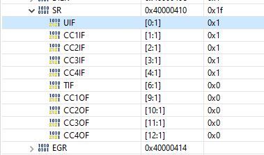

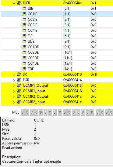

> The CNT registers are rolling
Timer keeps running even when the processor is stopped by debugger - except if you use the provisions of DBGMCU freeze registers (DBGMCU_APBx_FZ or similar). And, of course, running timer keeps setting the flags, too, including the Update flag, which is set each time CNT reaches ARR.
The CCx flags are set, as by default the CCx channels are set to Output with CCRx registers set to zero, so each time CNT goes to zero there's a Compare event. Setting of these flags is not "disabled" when bits in DIER are not set; it's the other way round: DIER bits being zero disable the status flags to trigger interrupts.

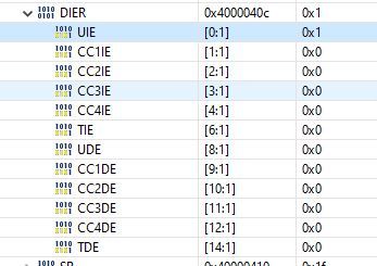

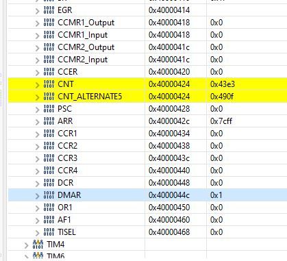

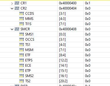

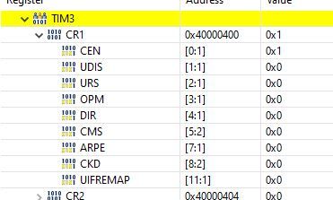

Show content of all other registers of TIM3.
Is TIM3 stopped while you're observing its registers?
2023-05-19 10:49 AM - edited 2023-11-20 5:04 AM
Yes we are in the interrupt 3/4 IRQ handler stopped just after the flag is supposed to be cleared(line #12 below.) The CNT registers are rolling and I've tried changing interrupt priorities but nothing yet. Just looking for other idea's at this point.
Thanks
2023-05-22 5:27 AM - edited 2023-11-20 5:05 AM
I do understand that the timers continue to run but I have never seen the interrupt flag not clear in the debugger. Timer 3 is running at ~ 100usec so I don't see how stepping over the flag clear would not show up in the debugger. I could see it if the timer was running a very short period but I don't consider 100usecs that short.
The timer 3 DIER->CCxIE register description says the capture compare interrupt is enabled. So if the DIER bit is not set(not enabled), why am I getting flags set in the SR register when the timer triggers?

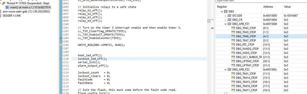

Have you tried to set the DBG_APB_FZ1.DBG_TIM3_STOP bit, yet?
2023-05-22 6:23 AM - edited 2023-11-20 5:05 AM
A write reg in the code seems to have no effect on the debug register. Do you need to do this from J-Link scripting or should this work?
Thanks
2023-05-22 7:53 AM
It may quite well be that the debugger (and by that I mean any component of the debug chain, including the IDE you are using) overwrites this register and/or prevents user from writing it. Try to browse the associated documentation.
[EDIT] It appears that you have to enable DBG clock by setting RCC_APBENR1.DBGEN first.

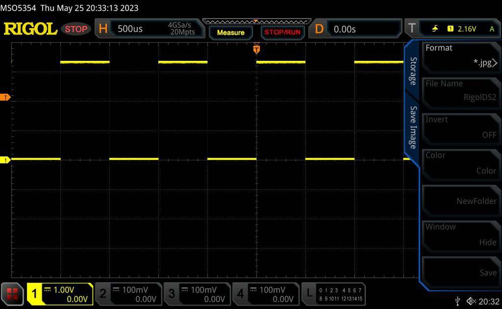

2023-05-25 5:39 AM - edited 2023-11-20 5:05 AM
Just an update. I put in a pin toggle in the interrupt and timer 3 is running correctly. I've also checked the DMA interrupt ISR register bits and they clear in the debugger. So maybe this internal micro design which is different from the ST F series and leaves the timers running(and is not stopped by the J-Link), is timing out again before the debugger can read the ISR register.
