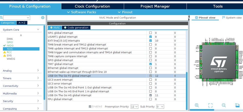

Hi, I'm testing the priorities of the modules, and I would like to know in which file the "Device Configuration Tool Code Generator" saved the NVIC definitions.
I have a lot of code outside the delimiters, I can't use the "Device Configuration Tool Code Generator", so I need to know which file is saved, and change manually.

A distinction must be made between
The IOC uses STM32CubeMX as the starting point for programme generation. The IOC is also used for later programme generation after a possible change in the configuration (further peripherals or pins to be used, etc.), whereby the own code parts between the above markers are retained (as long as the respective peripherals are not removed).
The NVIC priority is now stored in the IOC at the mentioned location for later programme generation. In the generated source code, however, the priority stored in the IOC is also inserted, e.g. in USB_HOST\Target\usbh_conf.c, depending on the USB function selected using e.g.
HAL_NVIC_SetPriority(OTG_FS_IRQn, xxx, 0);
I hope I understood your question correctly and could help you with it?

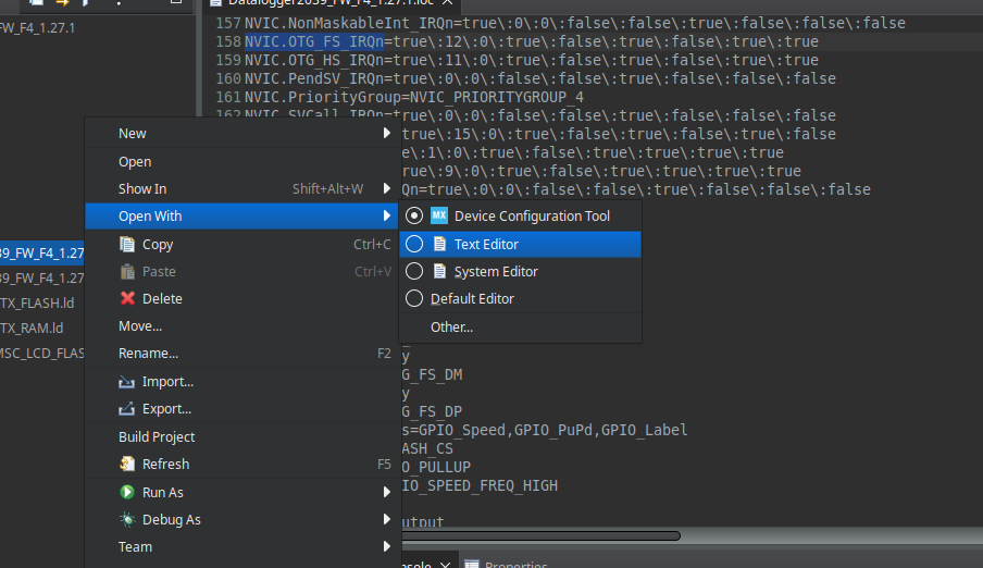

2023-06-23 3:41 AM
The NVIC definitions are stored in the IOC file, which is a text file, but you have to be very careful when modifying it so as not to destroy the structure. Since it is not intended for manual modification, there is also little documentation on the internal structure.
However, you will find the IRQ priority under NVIC.OTG_FS_IRQn.
Hope that helps?
Regards
/Peter
2023-06-23 10:31 AM
Thanks,
If the intention is not to be handled manually, how can I add delimiters in the code for the automatic generator to preserve my code?
2023-06-23 10:37 AM
This is the last place I would look, I thought this file was read only by "Device Configuration Tool Code Generator"
