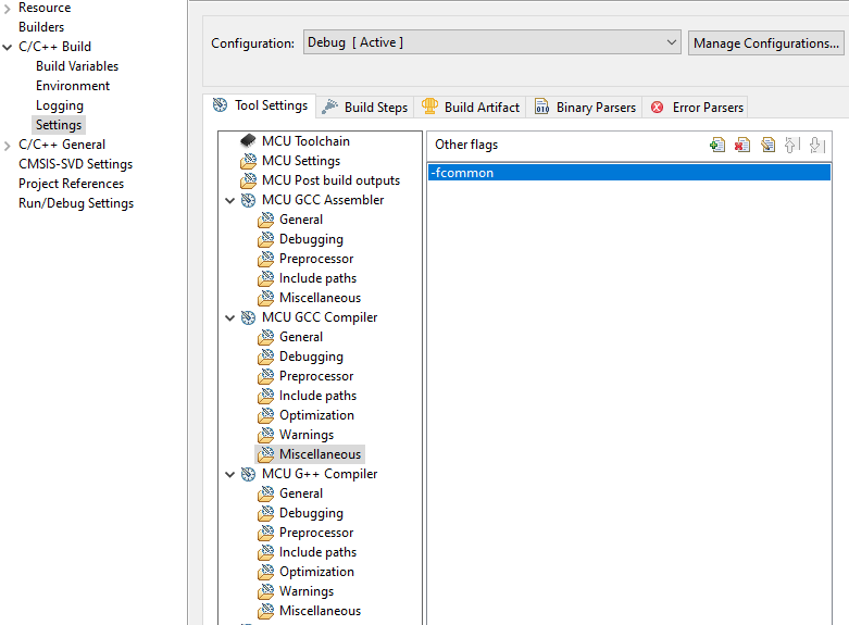

Hello. I think the change in GCC 10 to put -fno-common as default is causing your problems. CubeIDE 1.9.0 was first to use GCC 10 as default toolchain.
Try to add -fcommon flag to C/C++ miscellanous options.
