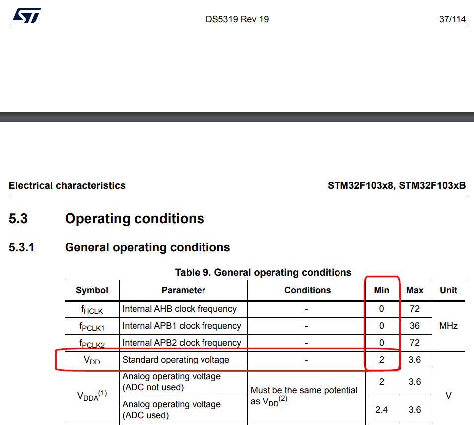

@mekatronik27 wrote:Voltage : 1.05V
Minimum operating voltage for stm32f103c8 is 2V:
https://www.st.com/resource/en/datasheet/cd00161566.pdf#page=38

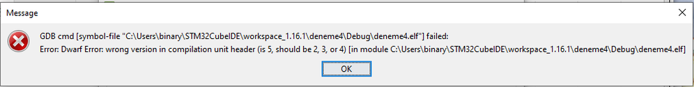

Could the reason for the error be related to this? I got this message when I called the elf file to follow the variable in the stm studio program. I have been trying to solve the problem for 3 days without sleeping, please help.

> After formatting my computer ...
Sounds a bit dramatic. I suppose you reinstalled the OS (probably including reformatting the disk drive).
> ... and reinstalling STM32CubeIDE, none of the code I write seems to run.
Are you sure it is the same version as before ?
The version might have changed since the previous installation.
> During the debug process, the microcontroller is accessible, but I am unable to determine if the code reaches the main() function.
I don't use CubeIDE, to put that upfront.
But I suggest to change the debug settings from "run to main()" to "break at the reset vector".
After that, step through the startup and system init code.
I suspect some startup files, header or libs have changed in the meantime, and doesn't match your code.
Thus you applications get "lost" in the startup code.

Voltage of 1.05 V is insufficient, suggesting issues here.

@mekatronik27 wrote:I tried it on stm32f103-blupilli and stm32f429disc card
Did they both give the same result?
An STM32F429 will also not work at 1.05V, and the stm32f429disc should be running at 3V.
Definitely something wrong here!
