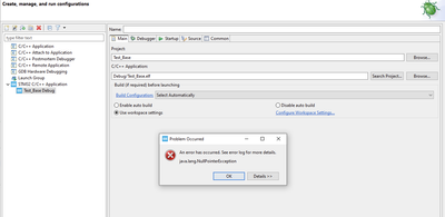

Ok, opening the debug window, I obtain a strange error:

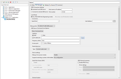

And I cannot see my ST-LINK connected after clicking to scan button:
This is very strange because I can correctly program the device with STM32CubeProgrammer..... This could be the problem?
2024-01-19 2:01 AM
here:
- deselect stlink S/N !
- set reset -> software (i use most time ; "under reset" only needed, if cpu in special conditions)

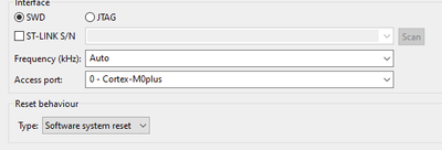

2024-01-19 2:06 AM
If I uncheck it, the box is empty:
And I have:

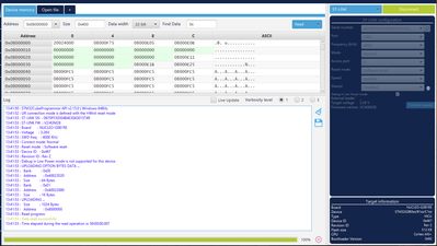

2024-01-19 4:46 AM
This is very strange because I can program through STM32CubeProgrammer software....

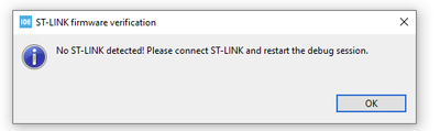

2024-01-19 5:17 AM
Try : in IDE (menu) Help -> ST-Link upgrade --- does it find the st-link here ?
2024-01-19 5:43 AM
No, it doesn't. I've tried with a fresh install of STM32CubeIDE but with no luck...
