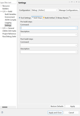

2025-09-12 2:16 AM
Hello @GHM
STM32CubeIDE supports running Python scripts in the Pre-build and Post-build steps, provided that Python is installed and accessible in your system’s PATH. To enforce GPIO configuration checks, place your check_ioc_lock.py script and your .ioc file in the project root directory. Then, in the IDE, right-click your project, select Properties ==> C/C++ Build ==> Settings ==> Build Steps, and enter the appropriate command to execute your Python script (e.g., python check_ioc_lock.py Temp-STM32H743VIHX.ioc) in the Pre-build steps field. This setup ensures that your script runs automatically before each build.
THX
Ghofrane
