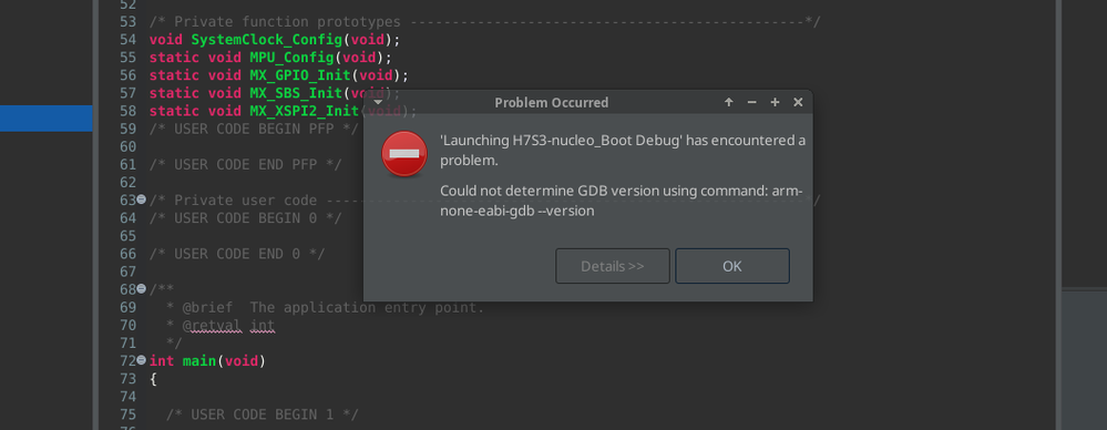

Initially I downloaded the Debian version of the IDE. Now I am using the generic Linux version. In both versions I could build the project, but in neither one of them could I run the program. I kept getting the error: Could not determine GDB version.

Then try debug: again , 3 minutes happens nothing (!), then:

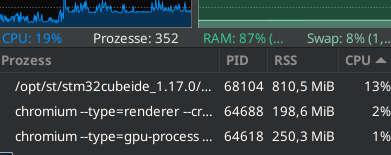

In these 3 minutes it makes 100% cpu load on one core (of 8, so about 13% ), so some heavy action...for nothing.
Maybe it cannot access something, but without any error message - how to find out, whats wrong?

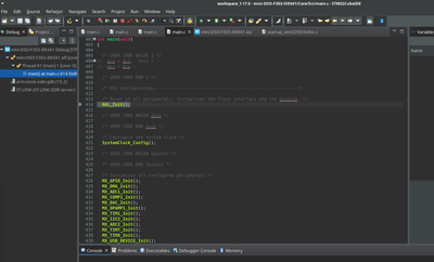

Now its starting gdb-multiarch ... as gdb:
