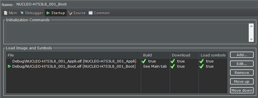

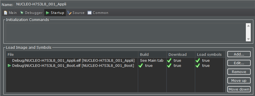

In the app's debug configuration, on the "Startup" tab, I had to add the bootloader.
Make sure they are in the correct order to avoid a hardfault when starting debugging, like shown below.
For the application it should look like this:
And for the bootloader it should look like this:
