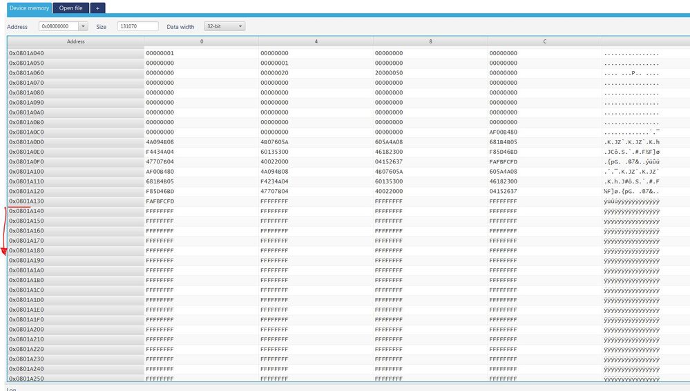

When I compile and program my project with the EEPROM package included, my Flash starts to free up space at 0x0801A140
So before my EEPROM start address was 0x08010000 and clearly overlapping.
Now I changed it to 0x0801A190 but the main code isn't running anymore.
For EEPROM emulation I need 2 pages of 2kbytes, 256 words of 64 bits
2021-08-27 12:34 PM
The EEPROM flash page must be located in a page not used by your code. It can't start midway through a page.
