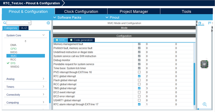

In this project,attached below, I'm using the two interrupts provided by the RTC: the interrupt that occurs every second and the alarm interrupt (I also have the Timer 3 interrupt enabled for additional testing).
The interrupt priorities are set in the following order (from highest to lowest priority):
  1. SysTick interrupt.
  2. Alarm interrupt.
  3. Global RTC interrupt.
  4. Timer 3 interrupt.
I must clarify that the priority of the SysTick interrupt should be higher than any of the RTC interrupts since it is used as a time reference for calculating timeouts in various functions of the RTC module.
