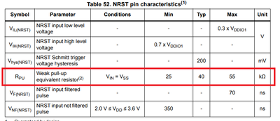

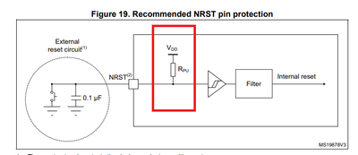

2024-10-29 1:23 PM
No need for an external pull up resistor as there is already an internal one.
From STM32G0 datasheet:
