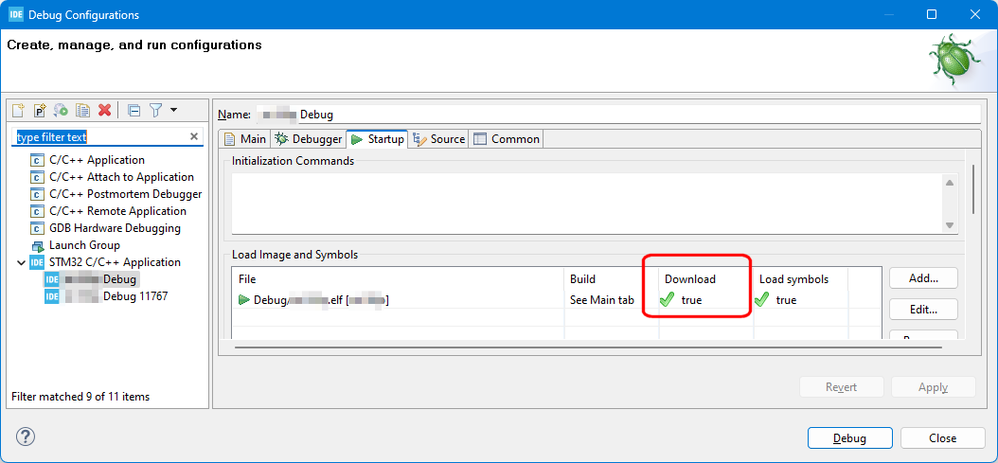

@ABouk.1 wrote:starting a debugging session doesn't load program into the STM32L5 target
Is downloading enabled in your Debug Config:

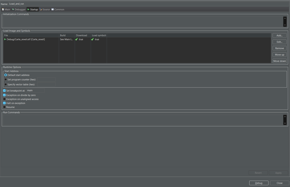

2024-07-15 4:47 AM

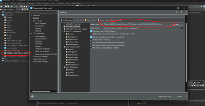

2024-07-15 8:16 AM
Hi @SMarie ,
I modified the STM32L562VETXQ_FLASH.ld and selected it in the linker script (in projet properties) as you can see in the attached screenshot.
In OpenOCD the program is loaded before debugging but in GDB server mode it jumps directly to debugging without erasing/programming the flash.

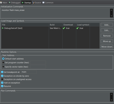

2024-07-18 3:07 AM
Update : When using the initialization command : "monitor flash mass_erase", the STM32CubeProgrammer v2.17.0 is invoked and performs the command, however calling load <project_name>.elf doesn't, it's like this command is just ignored.
Any ideas pls ?
