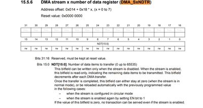

I am running ADC DMA in cyclic mode
at STM32G474CET6 Im useing
Buffer_Addr_At_Trigger[ ADC_Loop_Counter] = hdma_adc1.Instance->CNDTR;
to read the pointer of the cyclic buffer
In the STM32H7 family
An syntax error for CNDTR
I can't find the appropriate register in the documentation
Thanks
Haim

from what I understood from your question. I see that you are looking for the equivalent of the "DMA_CNDTRx" register in the DMA registers with the STM32H7A3. This register is the "DMA_SxNDTR" as you can find in the RM0455.
Best Regards.
