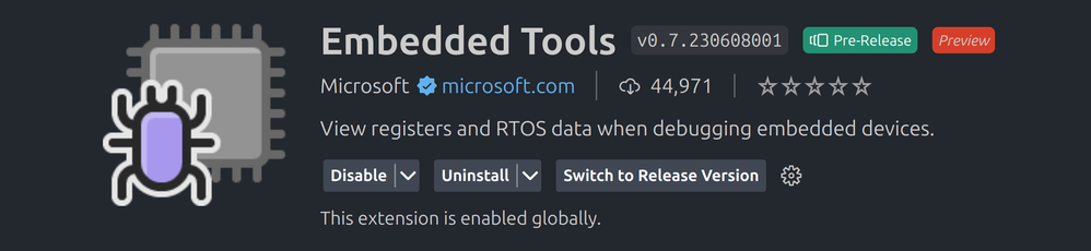

"vcpkg.diagnostics.additionalArguments": [ "--debug" ]Lots of debug and it did fail. But I did notice it was looking in /home/iwiseman/.cache/vcpkg. Removing this and retrying still did not work but need I went to extensions for embedded and installed pre-release
It did not work straight away but removing the vcpkg directory again and it did succeed.
