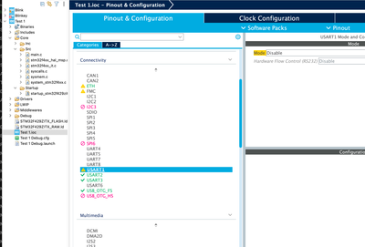

I am running CubeIDE on OSX (not sure if t hat makes a difference)
In the pinout & configuration you can see that some of the configured items, for example ETH and USART1 have a little green triangle next to them, indicating what I believe is a conflict.
If I hover the mouse over the icon, in just the right place, it will show a popup, but, no matter what I do, after a second of being visible, the popup disappears again, so I do not get long enough to read what its telling me, thus cannot figure out what I am being told.
Is CubeMX really this buggy/ Is there some other view I can look at that will give me information about these conflicts so I may try to resolve them?

2024-01-22 10:49 AM
If you talk about the yellow triangle ... :)
- this is only a warning, not all modes or pins available, because you already used some of them.
You anyway see details, when you click on the yellow marked thing, here your usart1 :
(mode , also yellow) will show you, whats available, or not (red). Thats all.
Yes, we all like some bugs in IDE more or less...

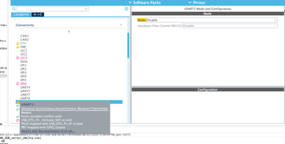

Unfortunately, clicking the icon does not show any addtional information, I guess thats an OSX thing. I did manage to grab a screen shot as @TDK suggested, so can see the error now. I cannot of course click on the documentation link to get more help. Unfortunately as a noob to these STM32 devices I really can only guess at what this even means,
Also, appreciate they are only warnings, thank heavens,,, if they were errors I would not only not know what they mean but the project would not work either lol
2024-01-22 11:51 AM
Misunderstanding - not ON the icon, just ie in usart1 "mode" click in the selection box "disable" , then you see , whats (still) possible or not.
CubeMX is a separate program, to edit the pinout + generate code then.
In IDE its just integrated, for a better "all in one" feeling. (Just the bugs...destroy the feeling ...)

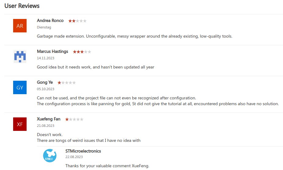

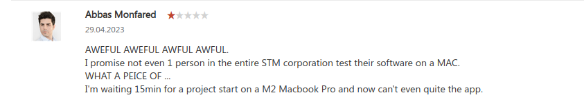

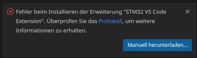

2024-02-03 4:29 AM - edited 2024-02-03 4:30 AM
My test on VScode with STM was surprisingly short :
... no install at all, after 5 minutes "thinking" (progress bar seems very busy...).
Also other user comments are ... :
