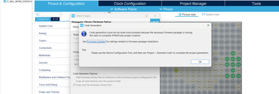

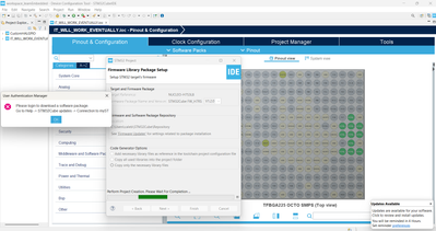

That said, after reinstalling STM32CubeIDE version 1.19.0, the code generation is locked behind an error message:
`Go to Help -> STM32Cube updates -> Connection to myST`. When I go to `Help->Check for Updates`, the only update available is to STM32CubeIDE 2.0.0. As I've explained above, I've been actively avoiding this version due to the removal of CubeMX integration in CubeIDE.
Seeing as this was the only update, I tried to simply go to`Project -> Generate Code`, but nothing happened.

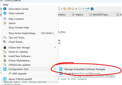

It needs the H7 software package to generate the code, hence the error message.
Go to manage embedded software packages and download the latest H7 package.
It might need a different package as well depending on what you enabled.
You may need to log in for some of them:

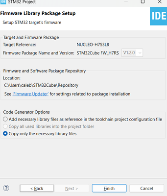

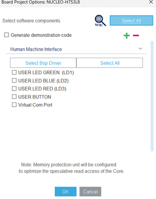

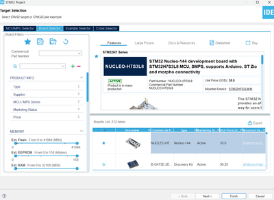

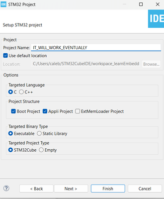

My error message looks like:
The pages where I make it looks like:

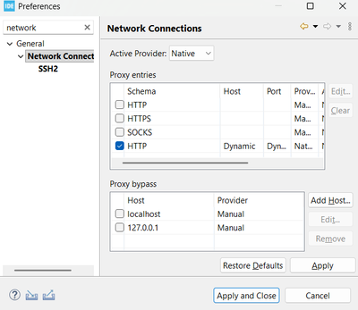

At first, I thought I needed to use this solution: https://community.st.com/t5/stm32cubeide-mcus/myst-login-issue-in-stm32cubeide/td-p/575447. However, I thought that with the settings below "these were not the same problems".
The only things I can brainstorm are STM32 hides their libraries behind a paywall (the email must be connected to a purchased stm32 board) and that this email is not the one I used to buy the account, or that I am not signed in elsewhere on the toolchain (I mean to say not signed in to a connecting software).I am still an overall coding beginner so I am unsure how valid this hypothesis is.
2025-12-29 11:56 PM
Thank you for your help and your patience. This worked to generate the code.
The display `Go to Help -> STM32Cube updates -> Connection to myST` led to a misunderstanding on my part that this required an update to fix, not the board packages needing to be installed.
