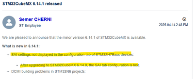

Could you please try to use the latest STM32CubeMX 6.14.1 version and/or STM32CubeIDE1.18.1 version.
The SAI tab configuration issue is fixed as mentioned in STM32CubeMx 6.14.1 released.
