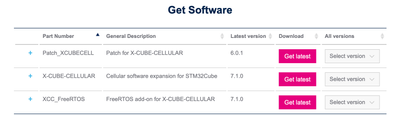

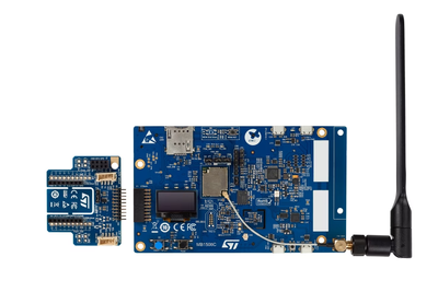

Ive got a B-L462E-CELL1 discovery board and I would like to use a demo software to learn how to use it for NB-IOT. I found the board in the Board selection tool when starting a new project in cube IDE, but no examples. If I see correctly, X-CUBE-CELLULAR is a relevant software expansion.

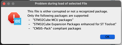

I downloaded it and tried installing using Embedded software packages manager, but Ive got this error:
I tried multiple advices from this forum and chatGPT, like trying to import it as a project, but without success. Just more errors.

Hi @Tobias_ ,
This article developped by @Guillaume K should help you to import the project you need properly: How to open a STM32CubeIDE X-CUBE project.
